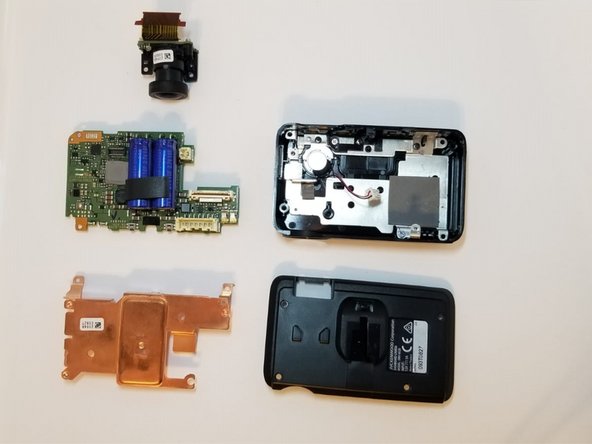

  1. Kenwood DRV-N520 Dashcam Speaker Replacement, Speaker: passo 1, imagem 1 %32 Kenwood DRV-N520 Dashcam Speaker Replacement, Speaker: passo 1, imagem 2 %32 Kenwood DRV-N520 Dashcam Speaker Replacement, Speaker: passo 1, imagem 3 %32
    • Use a Phillips #0 screwdriver to remove the four 3mm screws from the device backing.
    • Remove the backing.
  2. Kenwood DRV-N520 Dashcam Speaker Replacement: passo 2, imagem 1 %32 Kenwood DRV-N520 Dashcam Speaker Replacement: passo 2, imagem 2 %32 Kenwood DRV-N520 Dashcam Speaker Replacement: passo 2, imagem 3 %32
    • Use a Phillips #0 screwdriver to remove the four 3mm screws in the copper plate.
    • Remove the copper plate from the housing. The motherboard and capacitors should now be visible.
  3. Kenwood DRV-N520 Dashcam Speaker Replacement: passo 3, imagem 1 %32 Kenwood DRV-N520 Dashcam Speaker Replacement: passo 3, imagem 2 %32
    • Use the screwdriver to remove the two screws holding the motherboard in place.
    • Before attempting to remove the board, disconnect the camera by removing the ribbon cable from its corresponding connection on the board.
    • To remove the ribbon cable, use a plastic spudger to gently apply pressure to the lever that secures the cable in place while simultaneously applying a light pulling pressure on the ribbon cable.

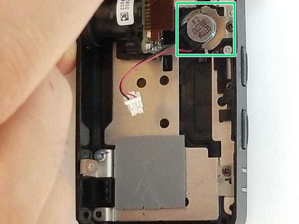

    • Disconnect the speaker connections (red and black wires) from the motherboard by applying pressure to the clip on its corresponding socket.
    • Once all connections have been severed, gently remove the motherboard from the device casing.
    • The speaker unit and corresponding mounting hardware should now be visible.
  4. Kenwood DRV-N520 Dashcam Speaker Replacement: passo 4, imagem 1 %32 Kenwood DRV-N520 Dashcam Speaker Replacement: passo 4, imagem 2 %32
    • Use your Phillips #0 screwdriver to remove the two 3mm screws from the speaker's mounting bracket.
    • Remove the speaker from the device.
Conclusão
To re-assemble your device, follow these steps in reverse order.
