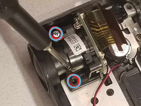

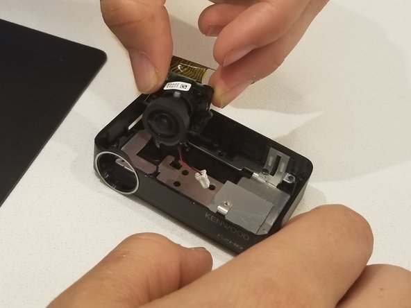

    • Remove the two 4mm Phillips #0 screws from the camera.
    • Lift the camera out from the device.
