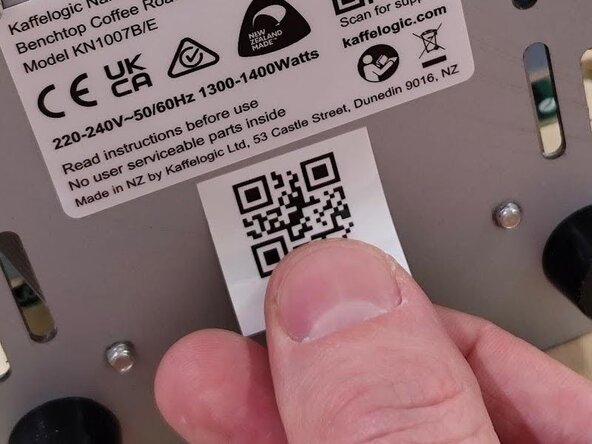

    • Your mainboard is now removed and ready for rework or replacement. Replace the serial code on the bottom of your roaster with the included QR label.
    • Head through to our wiki for instructions on recalibrating your fan speed and setting the voltage and element resistance after replacing the mainboard.
