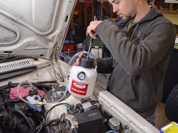

    • Place the Power Bleeder hose through the Power Bleeder cap and place the cap on the brake fluid reservoir.
    • Tighten the cap, ensuring that the gasket inside seats properly.
  3. How to bleed 1986-1993 Volvo 240 brakes: passo 3, imagem 1 %32 How to bleed 1986-1993 Volvo 240 brakes: passo 3, imagem 2 %32 How to bleed 1986-1993 Volvo 240 brakes: passo 3, imagem 3 %32
    • Place the cap on the empty Power Bleeder tank and tighten it.
    • Pressurize the Power Bleeder to 10 psi and check all connections for leaks.
    • Before making any adjustments or continuing, relieve the pressure in the Power Bleeder by slowly loosening the cap on the tank.
    • Never remove the reservoir cap before relieving the pressure inside the tank.
  4. How to bleed 1986-1993 Volvo 240 brakes: passo 4, imagem 1 %32 How to bleed 1986-1993 Volvo 240 brakes: passo 4, imagem 2 %32
    • Remove the cap from the Power Bleeder tank and fill the tank with two quarts of brake fluid.
    • Replace the Power Bleeder cap and tighten it fully.
    • Pressurize the system to a level between 15 and 20 psi.
    • Our race-ready Volvo is equipped with high-strength stainless steel brake hoses and racing brake fluid, which can handle significantly higher pressures than rubber hoses and conventional hydraulic fluid.
    • Never exceed 20 psi when pressurizing the Power Bleeder. Doing so may damage your hydraulic brake system.
