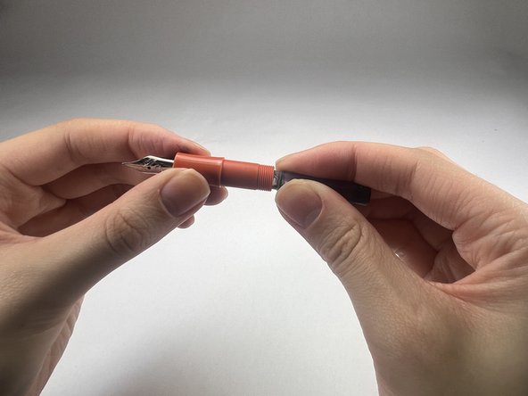

    • Disassemble the fountain pen.

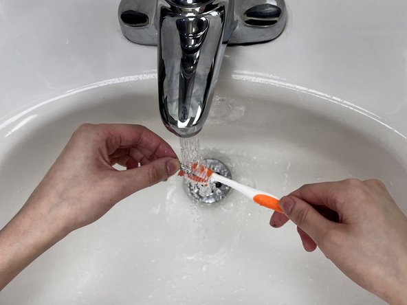

    • Remove the feed and nib from the section.
    • Separate the nib and the feed.
    • Run the nib and feed under warm water and use a soft bristle toothbrush to gently scrub the ink residue on the two pieces.

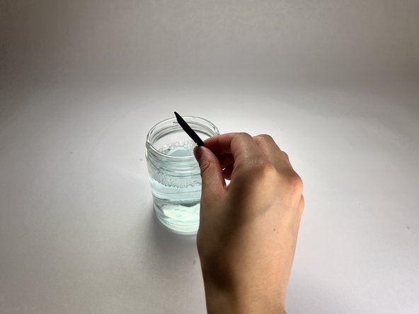

    • To create the cleaning solution, mix equal parts of ammonia and water in a container.
    • Add a few drops of dish soap to the solution and stir.

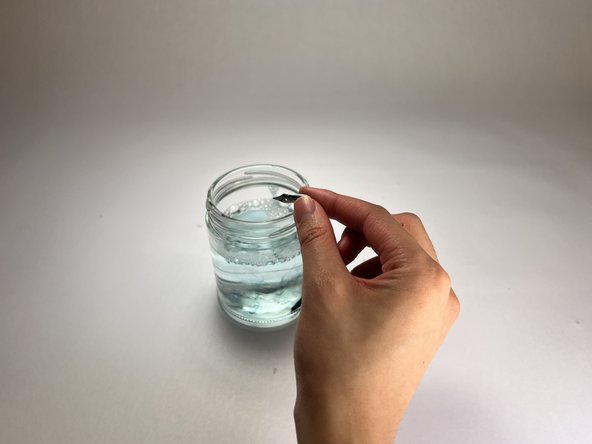

    • Drop the nib and feed in the cleaning solution.
    • Soak the pieces for approximately 12-24 hours.
