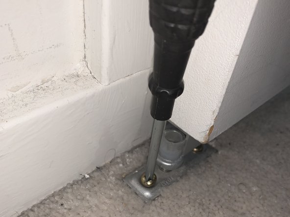

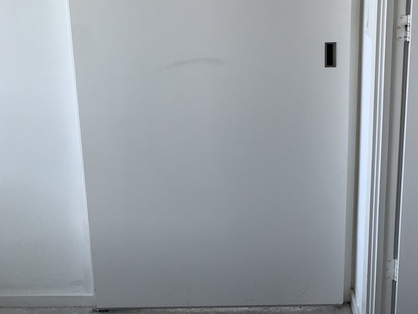

    • Investigate the cause of the unstable sliding door.
    • In this case you can see the sliding tract isn't aligned with the bottom roller.
    • You can also see that the screw at the base has been dislodged.
  2. How to Repair an Unstable Sliding Door: passo 2, imagem 1 %32 How to Repair an Unstable Sliding Door: passo 2, imagem 2 %32 How to Repair an Unstable Sliding Door: passo 2, imagem 3 %32
    • Remove the screws used to hold the door in place with a Phillips screwdriver.
    • Once the doors are loose from the tracks, remove them.
  3. How to Repair an Unstable Sliding Door: passo 3, imagem 1 %32 How to Repair an Unstable Sliding Door: passo 3, imagem 2 %32 How to Repair an Unstable Sliding Door: passo 3, imagem 3 %32
    • Check to see that the rollers are securely in place.
    • If there are any bits of debris present on the rollers or the tracks, clean it off with isopropyl alcohol and a clean rag.
  4. How to Repair an Unstable Sliding Door: passo 4, imagem 1 %32 How to Repair an Unstable Sliding Door: passo 4, imagem 2 %32 How to Repair an Unstable Sliding Door: passo 4, imagem 3 %32
    • Place the doors back on the rollers.
    • Replace the screws you removed earlier.
    • Check that the rollers move freely. You can test this by using your hands to roll them forward to your satisfaction.
  5. How to Repair an Unstable Sliding Door: passo 5, imagem 1 %32 How to Repair an Unstable Sliding Door: passo 5, imagem 2 %32 How to Repair an Unstable Sliding Door: passo 5, imagem 3 %32
    • Align the door on both tracks.
    • Start by attaching the head of the door first and then lower body into the track. Avoid forcing into the track as this might damage the rollers.
    • Make sure that it is aligned properly so it does not fall out in the future.
