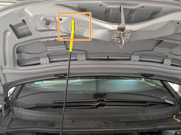

  3. How to Open the Hood of a Volkswagen ID.3, Secure the Hood with the Prop Rod: passo 3, imagem 1 %32 How to Open the Hood of a Volkswagen ID.3, Secure the Hood with the Prop Rod: passo 3, imagem 2 %32
    • Use one hand to hold the hood open temporarily while securing the hood with the prop rod:
    • Lift one end of the prop rod up or out to release it from the front area of the engine bay.
    • Swing the end of the prop rod up and slide it into the cutout on the underside of the hood.
    • Make sure the hood is well secured before you let go with your other hand, or it may fall and injure you.
