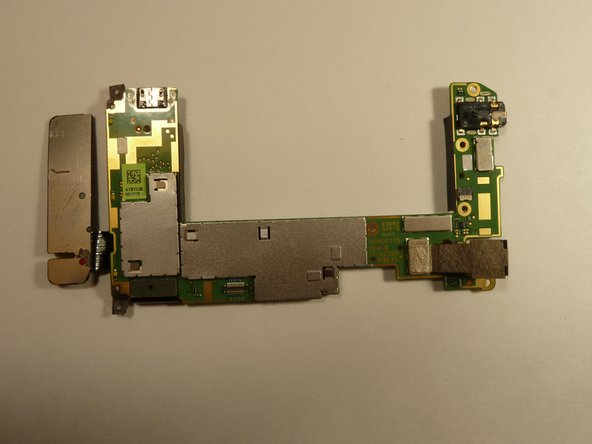

  16. HTC One V Camera Replacement: passo 16, imagem 1 %32
    • Place your phone on its side so that you can gently pull up on the motherboard to expose its last connector.
    • Using the flat end of the spudger, pop of the connector.
    Pergunte ao FixBot
  17. HTC One V Camera Replacement, Camera: passo 17, imagem 1 %32 HTC One V Camera Replacement, Camera: passo 17, imagem 2 %32
    • Flip motherboard over so the backside is up.
    Pergunte ao FixBot
  18. HTC One V Camera Replacement: passo 18, imagem 1 %32 HTC One V Camera Replacement: passo 18, imagem 2 %32
    Ferramenta utilizada neste passo:
    • Pull the camera back using the tweezers, and hold it.
    • Use the spudger to unlock the camera's ribbon from its connector.
    • Using the tweezers, pull up on the ribbon and release the camera form the motherboard.
    • The ribbon is connected to the back of the LCD display by tape. Slowly pull the ribbon back and the tape will follow.
