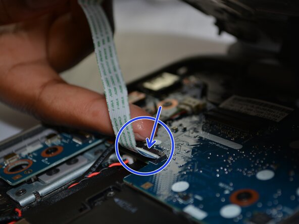

  5. HP ProBook x360 11 G3 EE Keyboard Replacement: passo 5, imagem 1 %32 HP ProBook x360 11 G3 EE Keyboard Replacement: passo 5, imagem 2 %32 HP ProBook x360 11 G3 EE Keyboard Replacement: passo 5, imagem 3 %32
    • Disconnect the two ribbon cables by lifting the tiny plastic flaps upwards to release them.
