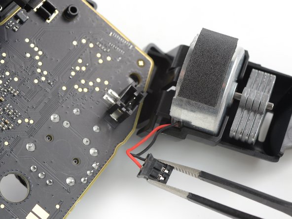

  27. Google Stadia Controller Vibration Motors Replacement, Disconnect the right vibration motor: passo 27, imagem 1 %32 Google Stadia Controller Vibration Motors Replacement, Disconnect the right vibration motor: passo 27, imagem 2 %32 Google Stadia Controller Vibration Motors Replacement, Disconnect the right vibration motor: passo 27, imagem 3 %32
    Ferramenta utilizada neste passo:
    • Use a pair of tweezers to disconnect the right vibration motor by pulling its connector straight out of its socket.
    • Use a pair of tweezers to carefully free the cable out the plastic hook of the midframe.

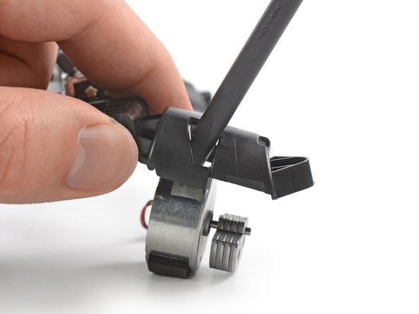

  29. Google Stadia Controller Vibration Motors Replacement, Free the right vibration motor: passo 29, imagem 1 %32 Google Stadia Controller Vibration Motors Replacement, Free the right vibration motor: passo 29, imagem 2 %32 Google Stadia Controller Vibration Motors Replacement, Free the right vibration motor: passo 29, imagem 3 %32
    • In the following procedure, hold the vibration motor housing as close to the motor as possible. Otherwise it could bend or break off.
    • Lift the plastic housing of the right vibration motor about 1.5 cm above your workspace.
    • Use a spudger to press against the vibration motor through the gap in the plastic housing.
    • Separate the vibration motor from its housing.

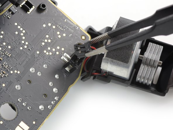

  30. Google Stadia Controller Vibration Motors Replacement, Disconnect the left vibration motor: passo 30, imagem 1 %32 Google Stadia Controller Vibration Motors Replacement, Disconnect the left vibration motor: passo 30, imagem 2 %32 Google Stadia Controller Vibration Motors Replacement, Disconnect the left vibration motor: passo 30, imagem 3 %32
    • Use a pair of tweezers to disconnect the left vibration motor by pulling its connector straight out of its socket.

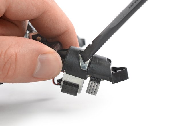

  32. Google Stadia Controller Vibration Motors Replacement, Free the left vibration motor: passo 32, imagem 1 %32 Google Stadia Controller Vibration Motors Replacement, Free the left vibration motor: passo 32, imagem 2 %32 Google Stadia Controller Vibration Motors Replacement, Free the left vibration motor: passo 32, imagem 3 %32
    • Lift the plastic housing of the left vibration motor about 1.5 cm above your workspace.
