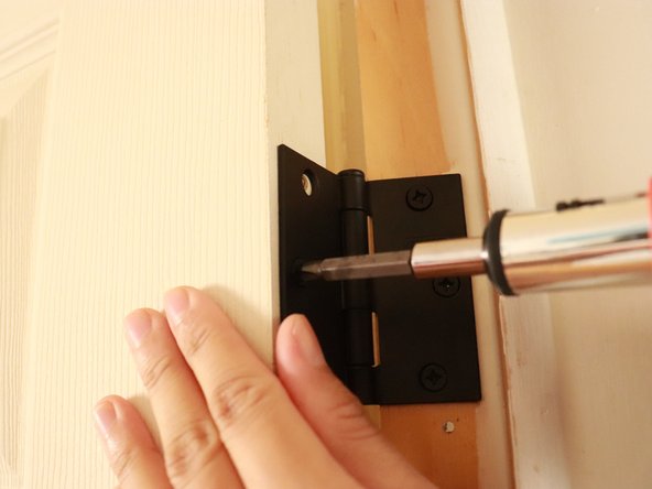

  3. Door Hinge Replacement: passo 3, imagem 1 %32 Door Hinge Replacement: passo 3, imagem 2 %32
    • Remove the three screws from the hinge that are connected to the door by using a Phillips 1 screwdriver.
    • Remove the three screws from the hinge that are connected to the door frame using a Phillips #1 screwdriver.

  7. Door Hinge Replacement: passo 7, imagem 1 %32 Door Hinge Replacement: passo 7, imagem 2 %32 Door Hinge Replacement: passo 7, imagem 3 %32
    • Align the new door hinge with the screw holes in the frame and screw in the new door hinge in the frame.
    • Repeat this with the bottom area of the door.
  8. Door Hinge Replacement: passo 8, imagem 1 %32 Door Hinge Replacement: passo 8, imagem 2 %32 Door Hinge Replacement: passo 8, imagem 3 %32
    • Align the new door hinge with the screw holes in the door and screw in the new door hinge.
