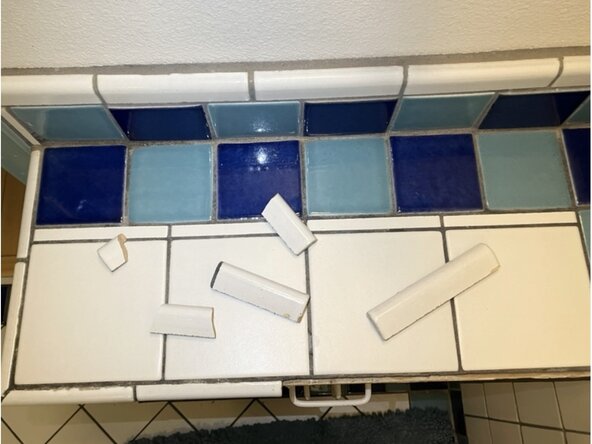

    • Collect all bullnose tile pieces that have fallen off into one place.
  2. Bullnose Tile Replacement: passo 2, imagem 1 %32
    • Locate the place where the bullnose tiles previously were (where the tiles broke off from).
  3. Bullnose Tile Replacement: passo 3, imagem 1 %32 Bullnose Tile Replacement: passo 3, imagem 2 %32
    • Align any tiles that may have broken.
  4. Bullnose Tile Replacement: passo 4, imagem 1 %32
    • To check you have all the tiles in the correct alignment, place the bullnose tiles along the edge that they broke off of to make sure they fit.
    • Remember, the standard size tiles (typically the longer ones) should be placed towards the center with the remaining tiles (typically the shorter ones) on the edge.

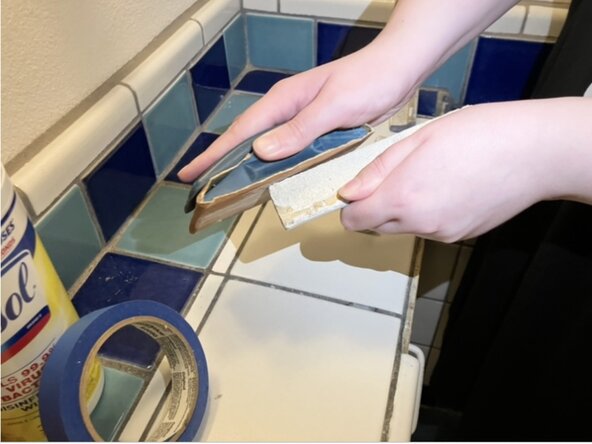

  7. Bullnose Tile Replacement: passo 7, imagem 1 %32
    • Sand off any extra bits attached to the tile that will impact reattachment (for example, general debris or unsavable tile slivers).
    • Keep in mind that some texture is good for the later reattachment, so sand sparingly.

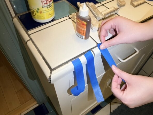

    • Prepare about three strips of painter's tape per complete tile or one per broken tile piece.
    • These tape strips will be used to hold the tiles in place while the glue dries, so make each one long enough to secure tightly over both sides of the tile.

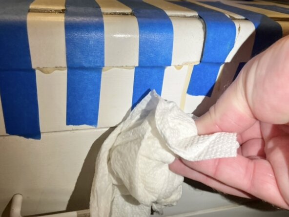

  15. Bullnose Tile Replacement: passo 15, imagem 1 %32
    • Use a paper towel to clean off as much dripping glue as you can.
    • Do not worry if you miss some; later there will be a more thorough glue cleanup step once the glue is dried.
  16. Bullnose Tile Replacement: passo 16, imagem 1 %32
    • While drying, the glue may foam and eventually become firm when dried. This is normal. This is how industrial grade glue gets to as much surface as possible for the best attachment.

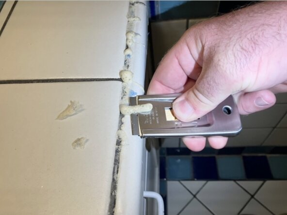

  18. Bullnose Tile Replacement: passo 18, imagem 1 %32 Bullnose Tile Replacement: passo 18, imagem 2 %32
    • Use your razor cutter to chip off the excess dried glue.
    • Remember to get the glue that has dripped past your working area as well.
    • Make sure you are never in the cutting path of the blade.
  19. Bullnose Tile Replacement: passo 19, imagem 1 %32
    • Use your standard scraper to remove as much dried glue that found its way between your tiles. This space should be made as clear as possible for grout.
