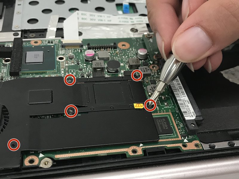

    1. Asus VivoBook Q200E-BSI3T08 Cooling Fan Replacement, Cooling Fan: passo 4, imagem 1 %32
      • Unscrew the five 4.9mm screws holding the cooling fan in place using a Phillips #0 screwdriver.
