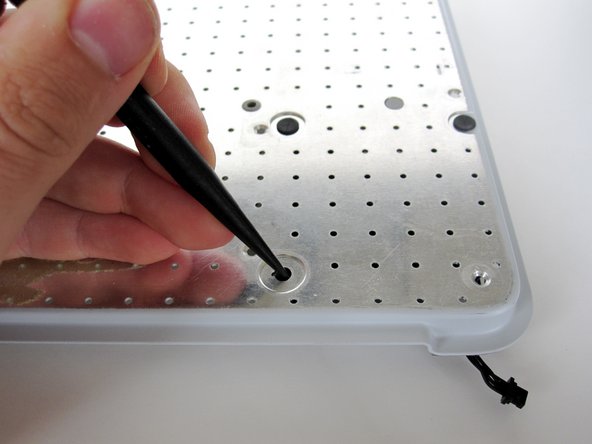

  4. Apple Time Capsule Model A1302 Fan Replacement, Fan: passo 4, imagem 1 %32 Apple Time Capsule Model A1302 Fan Replacement, Fan: passo 4, imagem 2 %32 Apple Time Capsule Model A1302 Fan Replacement, Fan: passo 4, imagem 3 %32
    • These three plastic plugs hold the fan in place.
    • Use a plastic spudger or similar and press the plugs through the case to release the fan.
  5. Apple Time Capsule Model A1302 Fan Replacement: passo 5, imagem 1 %32 Apple Time Capsule Model A1302 Fan Replacement: passo 5, imagem 2 %32
    • To re-seat your fan use a spudger or similar to force the plastic plugs back in the way they came out. This can be fiddly, but after a few tries you master it.
    • If you are replacing your fan, make sure that the plastic plugs are included. Or be prepared to re-seat your fan using an alternative method like double sided tape or nuts and bolts.
