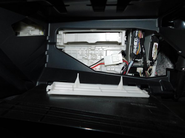

2023 Toyota Corolla Cabin Air Filter Replacement
  1. 2023 Toyota Corolla Cabin Air Filter Replacement, Cabin Air Filter: passo 1, imagem 1 %32 2023 Toyota Corolla Cabin Air Filter Replacement, Cabin Air Filter: passo 1, imagem 2 %32 2023 Toyota Corolla Cabin Air Filter Replacement, Cabin Air Filter: passo 1, imagem 3 %32
    • Open the glovebox.
  2. 2023 Toyota Corolla Cabin Air Filter Replacement: passo 2, imagem 1 %32 2023 Toyota Corolla Cabin Air Filter Replacement: passo 2, imagem 2 %32 2023 Toyota Corolla Cabin Air Filter Replacement: passo 2, imagem 3 %32
    • Unhook the dampener arm to see the cabin air filter.
  3. 2023 Toyota Corolla Cabin Air Filter Replacement: passo 3, imagem 1 %32 2023 Toyota Corolla Cabin Air Filter Replacement: passo 3, imagem 2 %32
    • Push in both sides of the glove box to lower the glove box.
  4. 2023 Toyota Corolla Cabin Air Filter Replacement: passo 4, imagem 1 %32 2023 Toyota Corolla Cabin Air Filter Replacement: passo 4, imagem 2 %32 2023 Toyota Corolla Cabin Air Filter Replacement: passo 4, imagem 3 %32
    • Unclip both sides of the housing cover and remove the filter frame, pulling outwards.
  5. 2023 Toyota Corolla Cabin Air Filter Replacement: passo 5, imagem 1 %32 2023 Toyota Corolla Cabin Air Filter Replacement: passo 5, imagem 2 %32 2023 Toyota Corolla Cabin Air Filter Replacement: passo 5, imagem 3 %32
    • Remove the old filter and install the new cabin air filter with the air flow indicating down.
    • Reinstall the cabin air filter and reclip the housing door.
  6. 2023 Toyota Corolla Cabin Air Filter Replacement: passo 6, imagem 1 %32 2023 Toyota Corolla Cabin Air Filter Replacement: passo 6, imagem 2 %32
    • Reinstall the stoppers and the dampener arm, then close the glovebox.
