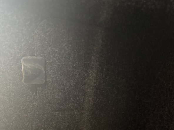

    • Use the interior trunk release to open the trunk.
    • Peel back the perforated carpet flap behind the taillight to reveal the rear of the left-side light assembly.
