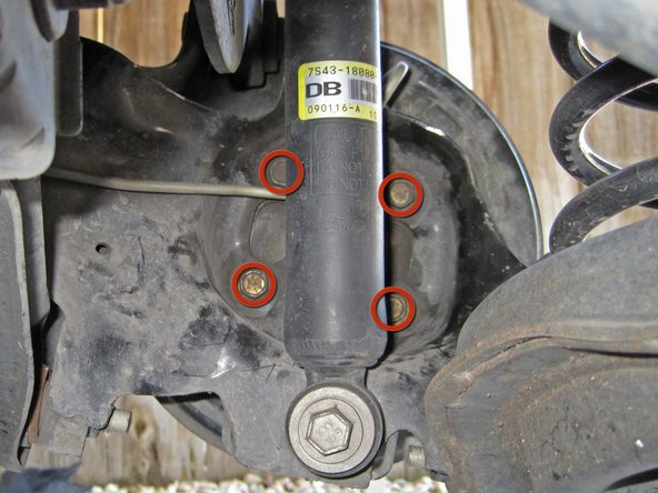

    • This step is for removing the brake drum without the rear wheel bearing.
    • Use a socket wrench with a swivel adapter to remove the four 13 mm bolts from the back of the hub assembly.

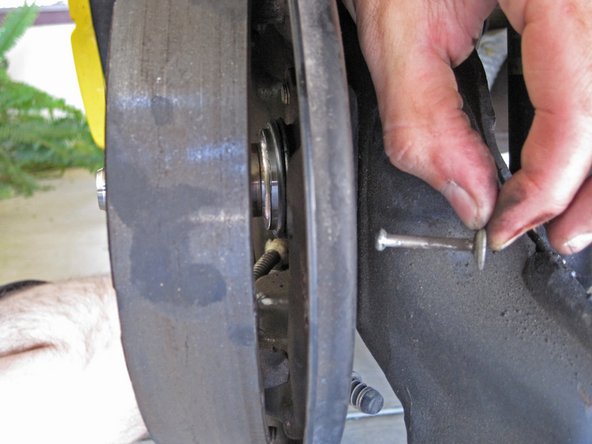

    • Use a flat head screwdriver to remove the two brake shoe retaining clips.
    • Pull the small retaining pins out from the back side of the hub assembly.

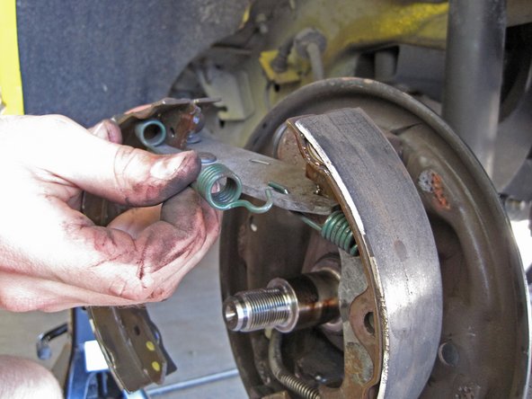

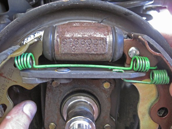

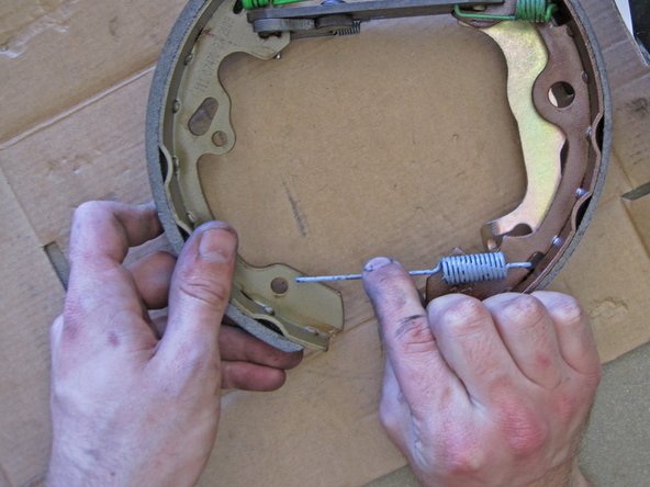

  7. 2005-2007 Ford Focus Brake Shoes Replacement: passo 7, imagem 1 %32 2005-2007 Ford Focus Brake Shoes Replacement: passo 7, imagem 2 %32 2005-2007 Ford Focus Brake Shoes Replacement: passo 7, imagem 3 %32
    • Pull the brake shoe assembly off the backing plate.
    • Remove the two springs from the top and bottom of the brake shoes that hold the leading (front) and trailing (rear) shoes together.
    • Remove the leading brake shoe.

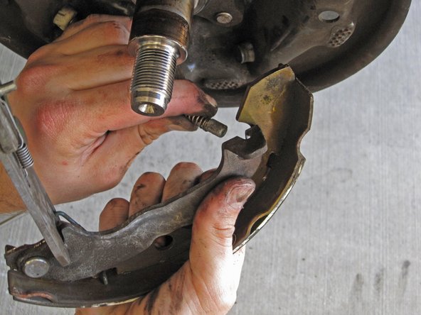

    • Remove the emergency brake cable from the trailing brake shoe by feeding it through its hole in the trailing shoe.
    • The cable only sits in the shoe in one orientation. Be sure to note how it is installed for reassembly.

    • Use a pair of needle nose pliers to remove the small spring that holds the trailing brake shoe to the metal spacer.
    • Remove the trailing brake shoe from the spacer.

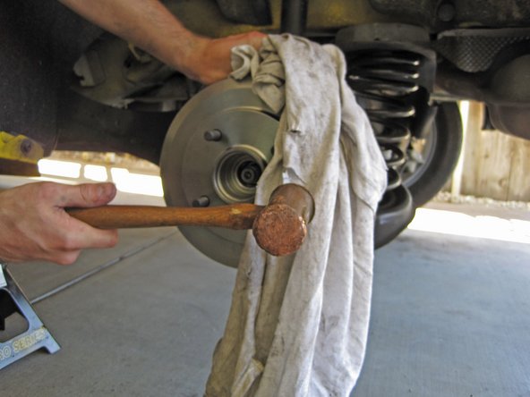

    • Place the brake drum back on the hub.
    • Use a rubber mallet to knock the brake drum into place over the shoes.
    • If you don't have any sort of soft mallet, place a rag over the drum to protect it before knocking it into place.

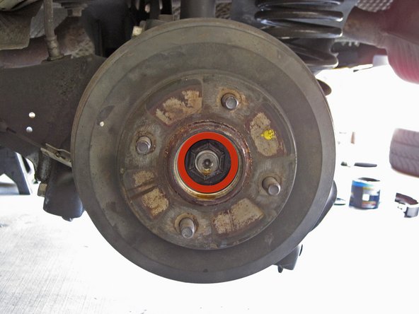

    • If you removed the wheel bearing with the brake drum, reinstall the rear hub nut.
    • Torque this nut to 175 ft-lbs. Failure to properly tighten this nut could lead to premature wheel bearing failure.
    • Reinstall the wheel bearing dust cap.
    • If you removed the brake drum by itself, reinstall the four retaining bolts on the back of the hub assembly.
    • Torque each bolt to 49 ft-lbs.

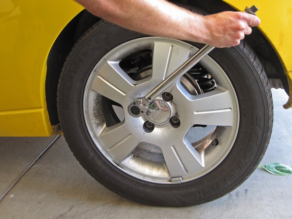

    • Reinstall the rear wheel and lug nuts.
    • Torque each lug nut to 94 ft-lbs.
