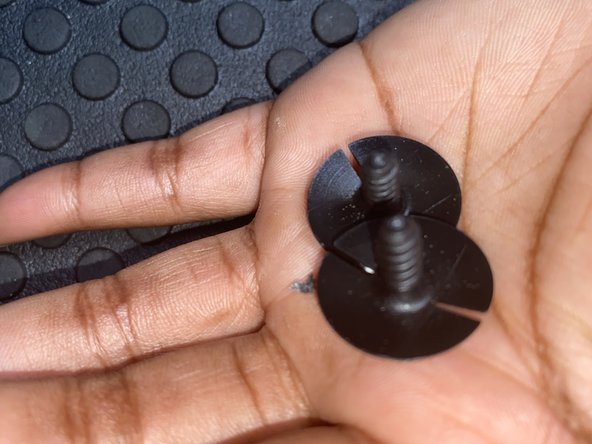

  3. 2005-2011 Volkswagen Jetta Cabin Air Filter Replacement: passo 3, imagem 1 %32 2005-2011 Volkswagen Jetta Cabin Air Filter Replacement: passo 3, imagem 2 %32
    • Using a flat-head screw driver, remove the 2 screws on the foam cover by screwing counter clockwise. Store the screws in a safe place.

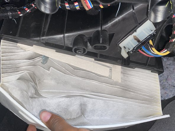

  6. 2005-2011 Volkswagen Jetta Cabin Air Filter Replacement: passo 6, imagem 1 %32
    • Pull out the dirty/old cabin air filter.

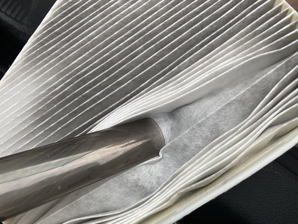

  7. 2005-2011 Volkswagen Jetta Cabin Air Filter Replacement: passo 7, imagem 1 %32
    • Depending on the condition of the filter you can either vacuum or replace with new filter. Vacuum dirty filter or remove packaging on new filter.
