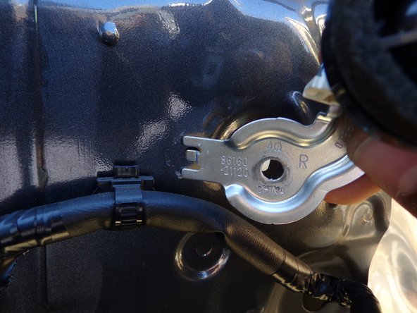

    • The tweeter speaker is located at the upper left corner of the door next to the door handle.
    • To remove the tweeter speaker, detach a wire using the same process as the previous two steps. Hold onto the clip on the side as you pull the wire.
  13. 2004-2010 Scion tC Passenger Door Tweeter Speaker Replacement: passo 13, imagem 1 %32 2004-2010 Scion tC Passenger Door Tweeter Speaker Replacement: passo 13, imagem 2 %32 2004-2010 Scion tC Passenger Door Tweeter Speaker Replacement: passo 13, imagem 3 %32
    • Use the socket wrench with a 10mm socket to remove the nut.
    • Hold onto the speaker itself after removing the nut.
  14. 2004-2010 Scion tC Passenger Door Tweeter Speaker Replacement: passo 14, imagem 1 %32 2004-2010 Scion tC Passenger Door Tweeter Speaker Replacement: passo 14, imagem 2 %32 2004-2010 Scion tC Passenger Door Tweeter Speaker Replacement: passo 14, imagem 3 %32
    • Holding onto the speaker, pull it towards you slowly until there is some resistance.
    • Pull the speaker from the angle you are currently on to to the right. The speaker will be free to be replaced with a new tweeter speaker.
