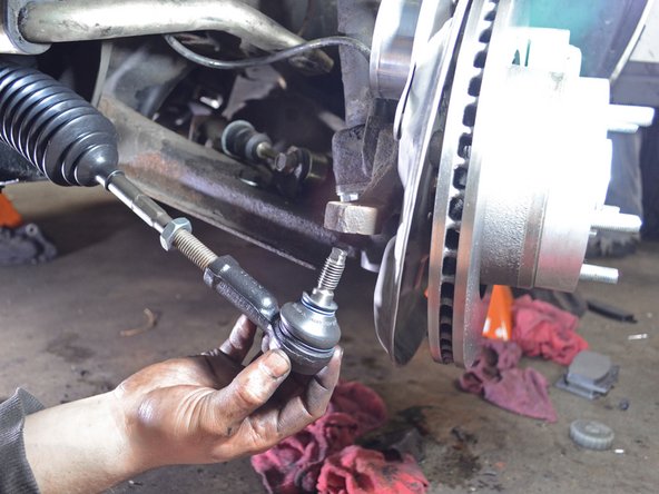

    • Install the inner tie rod end into the steering rack and tighten it with groove joint pliers.
  7. 1986-1993 Volvo 240 Tie Rods Replacement: passo 7, imagem 1 %32 1986-1993 Volvo 240 Tie Rods Replacement: passo 7, imagem 2 %32
    • Pull the inner tie rod boot completely over the inner tie rod and onto the steering rack.
    • Secure the boot in place with whatever hardware came with your new tie rods.
    • If your new tie rods did not include hardware for the boot, a zip tie will work just fine.
  8. 1986-1993 Volvo 240 Tie Rods Replacement: passo 8, imagem 1 %32 1986-1993 Volvo 240 Tie Rods Replacement: passo 8, imagem 2 %32 1986-1993 Volvo 240 Tie Rods Replacement: passo 8, imagem 3 %32
    • Place the tie rod end through its hole next to the brake rotor.
    • Install the tie rod end nut and tighten it to 44 ft-lbs with a torque wrench or impact gun.
