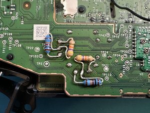

This question is regarding the warning about compatibility of the Gulikit TMR Joystick with the Xbox Elite series controllers. There is a warning stating "Not recommended for Xbox Elite or Xbox One controllers due to unavailable software for joystick calibration." This doesn't make any sense because the Elite controllers actually use the Xbox Accessories app that has built in joystick calibration software. The very same software I see being used to calibrate the joysticks for the regular Xbox non-Elite version controllers.
I'm assuming the actual issue of compatibility is the different style of stem that has a thread to screw the Elite series thumbstick cover on. If that is the case, then my second question is if it is possible to replace the stem of the Gulikit thumbstick with the stems from Elite thumbsticks or not? I would really like to be able to replace the thumbsticks with TMR type if possible. The product page states that lack of calibration software is the issue, but I believe that is incorrect and the real problem is the stem difference. I would appreciate any feedback from anyone that has attempted this or knows enough about the TMR joysticks to know if they can be modified to fit the Elite 2. Thanks.

I purchased and installed what appeared to be a genuine Alps stick with a Ginfull TMR installed, sold on Amazon in my country. Since the Elite 2 controller supports the Xbox app, calibration can be performed. The resulting circularity was remarkably close to the genuine stick. However, depending on the TMR used, the magnet for the paddle buttons directly below the joystick may interfere, requiring countermeasures. Specifically, this involves applying copper tape and then insulating it with Kapton tape. After about six months of use, it works flawlessly alongside the genuine stem. Alternatively, transplanting only the sensor part from the Gulikit might also work.

I tried installing the K-SILVER JS13-PRO on another Elite2. It has a dedicated Elite2 configuration, allowing the stem to screw in directly. The sensor and magnet are separated, with the magnet fixed to the case, which seems to help suppress jitter. However, it was significantly affected by the rear paddle magnet, making stick movement extremely fast during actual use and rendering it unusable without adjustment. Ultimately, transplanting only the hallpi sensor onto the stock stick worked perfectly.

The sensors from hall effects and tmrs can provide a too powerful of a signal and glitch the signal processor. It can't be fixed in software but a hardware solution is needed. Specifically a voltage division. With 47k and 100k ohm resistors soldered to these positions on the sensors. It takes care of all the issues. 100k and 150k ohm resistors can be used for a less aggressive sensor output chop. I have done dozens of xbox controllers with this fix.
