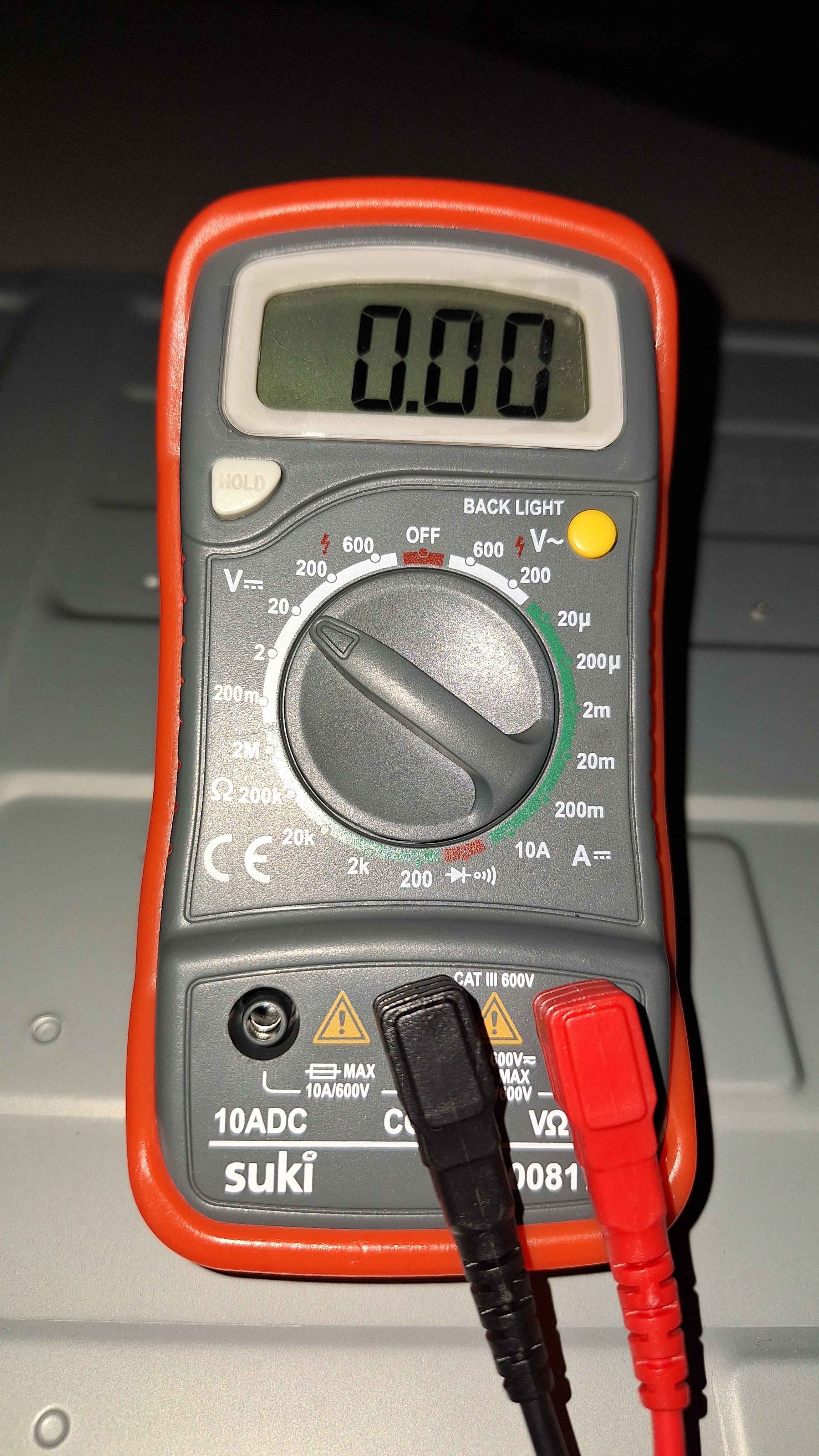

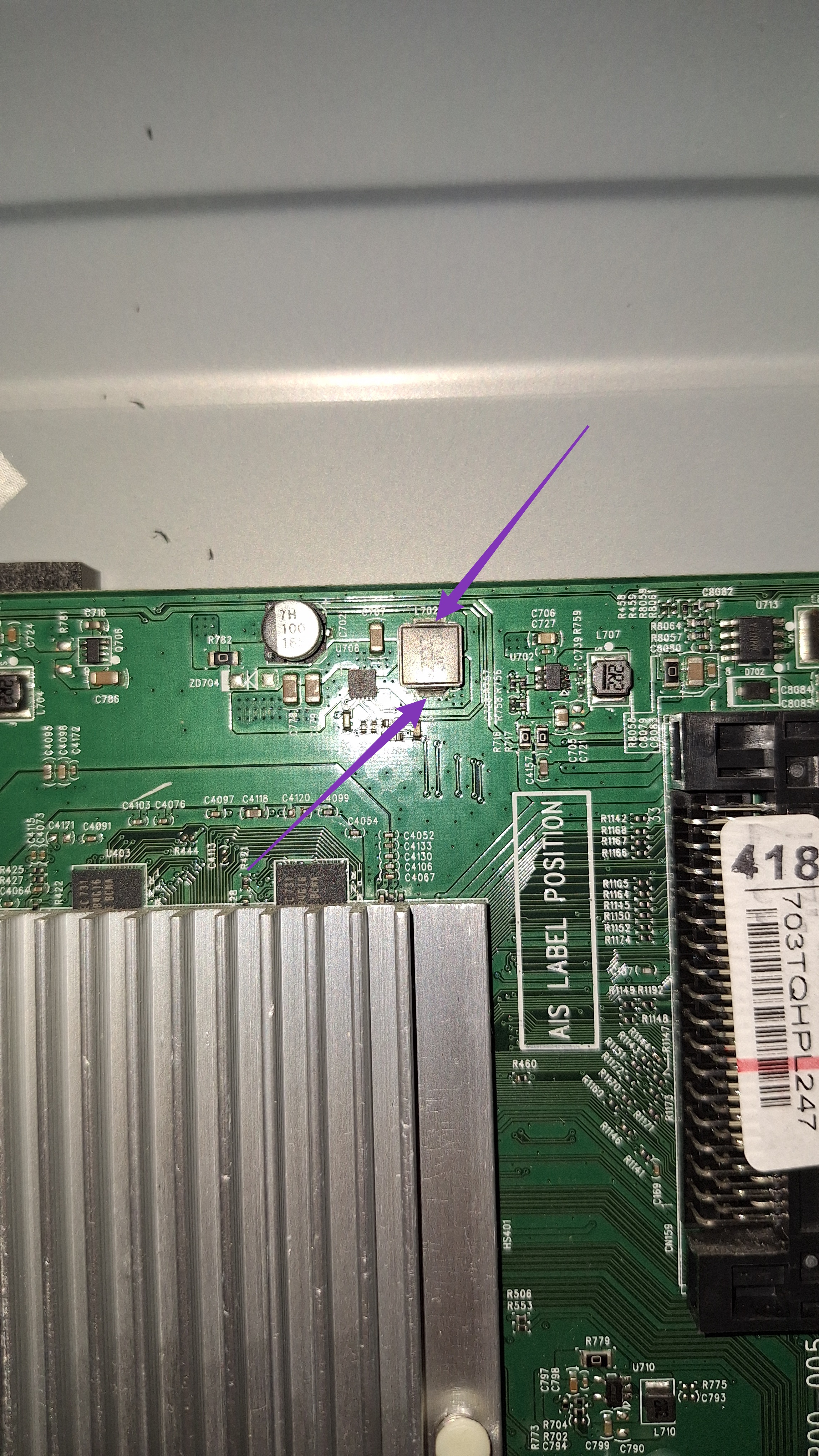

Thank you for your answer, issue is that i got a multimeter but i am not well with using it. So i am trying to read 5v so i put it on the 20v setting. I then place the 2 pins on either side of the black square and it reads 0 (https://i.gyazo.com/19348be37601388d5cbb...). It also reads 0 when i put it on both sides of the fuse on the powerboard but the screwdriver lights up on both sides.
I will edit this reply on the PC to add links to the images i just took.

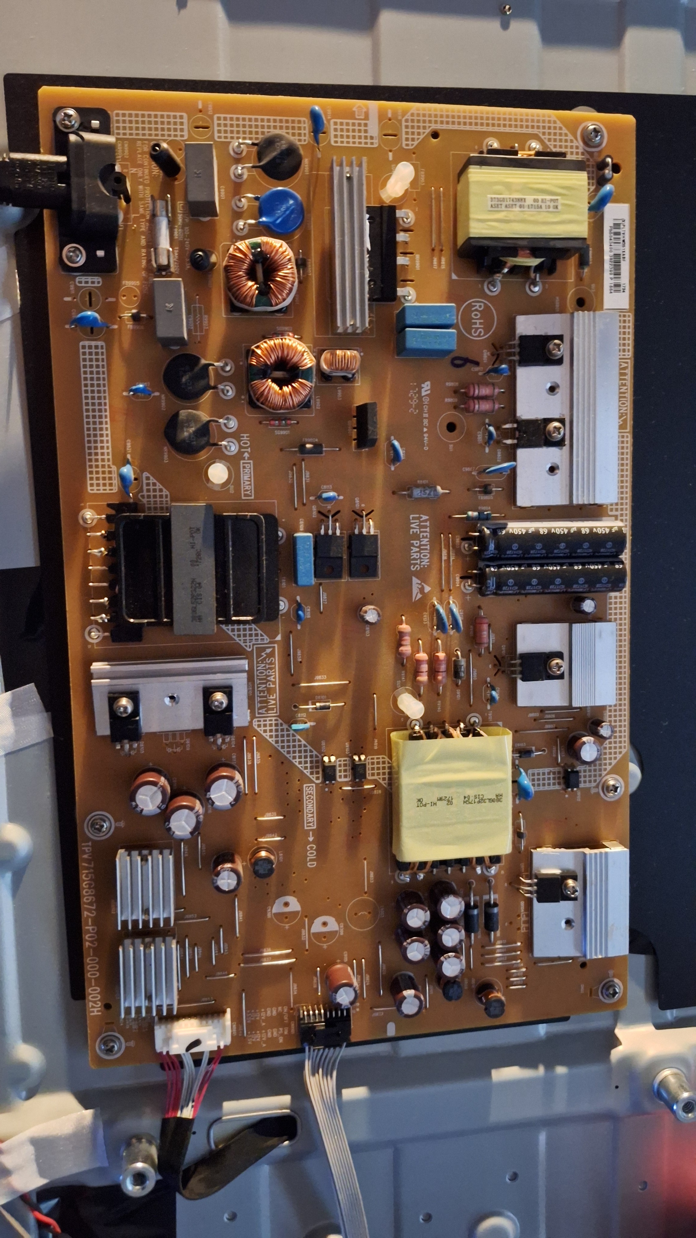

Powerboard: https://i.gyazo.com/1c532934e0ac22732b23...
multimeter: https://i.gyazo.com/9bdff57b228d5db6a0a0...

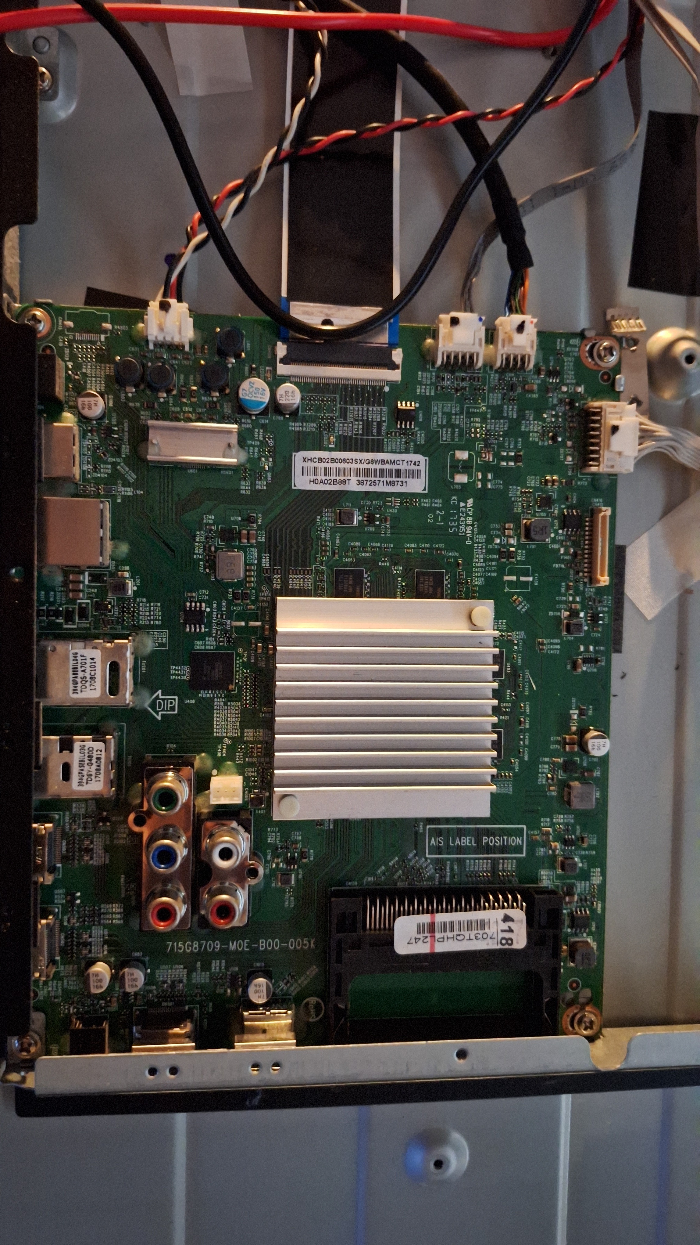

Other board: https://i.gyazo.com/4de47bd764b5acb91bcd...

You need to connect the meter between one side of L702 on the mainboard and an earth point e.g. screw head of screw holding board, to see if there's 5V there or not.
por
Just stays at 0v, the fuse on the powerboard goes from -1.64 to 1.64. So now i should follow the pieces in the diagram to see where it stops showing a voltage?
I also went to check the cable attachments from the powerboard to the other board and when connecting a pin a ground they all don't show anything

@koenpeters
On p.48 of the manual, mainboard connector CN701 pin 1 it shows the standby power connects there, so if it is not there also, you need to trace back the wire from pin 1 to where it goes to the power board.
I can't find it is the circuit on the board but looking at the wiring on p.8 it "might" go to CN9101 on the power board but I'm not sure.
If it is not there also then there's a problem with the power board.
You have AC in OK but no standby DC out.
p.39-p.41 are the power board circuit if you want to try and trace where the problem is.
Be careful when testing as there's exposed lethal AC on the power board

Thank you, going to try that if the problem is most likely in the powerboard i will just order a new powerboard
