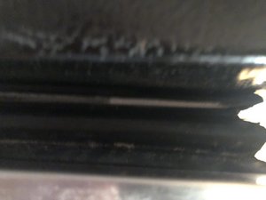

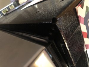

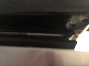

I have a Kenmore fridge. The top of the freezer door is not level (it is dropping as you go away from the hinge and get closer to the handle side of the door) and it is causing a gap where frost is collecting on the outside of the seal. The gap is on the handle side of the fridge, opposite the hinge, at the top of the door. When I undo the two screws that are holding the top hinge plate in place and make the door level, the holes in the hinge plate do not line up with the pre-drilled holes in the top of the fridge. Should I just drill new holes? What other options are there to fix this?

Hi @mikegibb ,
What is the model number of the fridge?
How old is the fridge?
If new has it always been like this.
Not quite sure but drilling new holes may not be a good option. You don't know what you are drilling into, whether there is enough metal to hold the bracket behind the skin of the cabinet and therefore hold the weight of the door or even if there is any wiring behind where you want to drill which you wouldn't want to hit
Wondering if the hinge bracket has been (or has become) bent so that it doesn't line up with the holes any more. Perhaps a new hinge bracket may solve the problem
